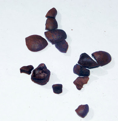

Part Friday rant and part for information the couple of photos below are from a mainstream mid to large sized roasting company. The photos below are just a random sample from mid way through a 1kg bag of their standard blend. Not a sponsor here either ;)
This company has had a slide in both flavour profile over the last year and this sort of defective bean is becoming far more prevalent. Getting to a point where I won't be buying this one again.

  • That's an awful lot of dud coffee beans when you consider it's just 40 grams of a 1 kilogram package.
  • That was my thoughts too, a few are expected but when the flawed ones are getting to that level it is beyond acceptable. There is some industry scuttlebutt about the bean sourcing being inferior to previous years and it shows. None of my own unsorted roasts have ever gone anywhere like this sort of level of defects.
  • Sorry T, but I cant see into the photos properly. Some of it for sure is due to damage caused probably in the destoner or roasted beans unloader  OR in the roasted beans to silo loader (ie the settings are too aggressive on the roasted beans) but I cant see much else...... You will have to take a better quality of photo for me to take a better look.......FotographySnobs anyone??? ;) Be aware that brokens from rough handling dont necessarily affect anything other than the visual quality and should brew out fine in amongst the rest of the whole beans. Seriously, are you able to supply better photos? Rgdz, A.

    Nope but they are a sponsor elsewhere we have spoken about before. Their beans once roasted are packed into 10kg cardboard boxes so there shouldn't be to many post packaging issues . Looking at them most are defective prior to roast. A fair number of them are hollow defects (thin and fragile) which I suspect contributes to the broken up bits during roasting or handling. It is more the disappointing and marked change in a year of what used to be a good all round blend.

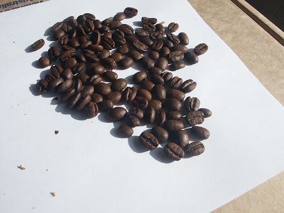

  • Todays sample had a few less hollows in it than yesterday and the bottom of the bag has more fragments that had settled out as you would expect. Rough sort Defect1.jpg Good Pile Defect2goodpile.jpg Defects roughly sorted Defect3sorted.jpg Chips and small bits Defect4chips.jpg Hollows and halves Defect5hollowsorsplits.jpg Broken, Deformed and divots. Defect6broken%2526divots.jpg
