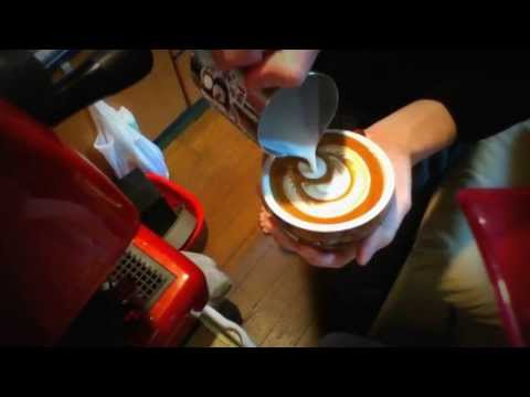

    I didn't do a whole heap of steaming. But I don't remember having any major problems getting usable microfoam. I point the tip straight down, just below the surface, and against the right hand side of the jug. Then hold the jug still and let the steam do all the work. Here's an old pic I have of Oscar microfoam. I suck at latte art  :(
  • And while I was digging through the old pics I found this. Naked pour with VST15g.

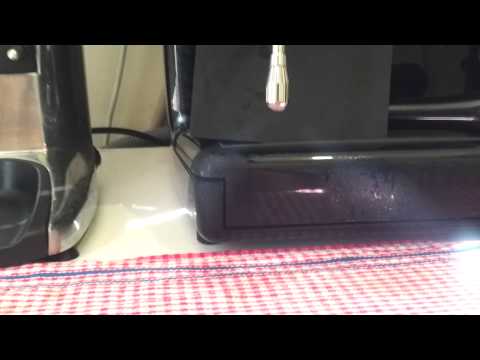

  • Nice looking pour shots there chaos  :thumb: Here's a quick and dirty video of my Oscar's steam coming out of the original 4 hole tip. Does yours do the same?
  • I'm not sure if mine pulses like that. I'll fire it up tomorrow and let you know. You could try taking the plastic check valve out of the back of the steam valve and see if that makes a difference. It could even be broken. They are crappy little flimsy things. The check valve before the HX is exactly the same. Mine broke so I replaced it with the one from the steam valve.

  • on 1391847785:
    I fired up the Oscar this morning. And yes my steam does splutter a bit. Maybe not quite as much as yours but it's still there. I could hear something hissing inside the machine so I opened it up. Leaky pressurestat  :(

  • It looks like the one in the bottom of the tank. But much smaller. If you do a google image search for "ns oscar check valve" you'll see a heap of busted ones. Don't go sticking anything in there to hook it out unless you're sure it's busted. Cos you're really likely to break it. I was thinking the pulsing could just be condensation blowing through the wand tip. The steam valve is quite large and isolated from the boiler so it's going to be very cool compared to the steam that's passing through it. On my machine the spluttering lessens once the steam valve has been open for a while (and heated up?). Maybe  ???

    Im pretty sure thats not normal. Someone posted something really similar on the other site. I had something like that when I overfilled the boiler. Perhaps you need to push the fill sensor on top of the boiler in a little further. Is the steam wet when it splutters? I can't really tell.

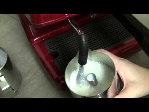

  • In relation to the retention valve, the service center has given it the machine a thorough check and given the ok. I,ve just stumbled upon this video by the girls at Seattle Coffee Gear. They don't seem seem to have mastered the steaming in the conventional way on the regular jug nor the Steam To Perfection jug. Coarse bubbles which they had to pound away on the table to get rid of. This is the same problem I am having. This guy however, seem to make it very well on the Sproline Knife steam tip. Nice whirlpool going and silky microfoam worthy of decent latte art as evident on this video. The tip is designed to create hydrodynamic cavitation which implodes bubbles into nano bubbles. Would love to have it but the price puts it out of my budget as far as steam tip goes. Hope to produce my own steaming video this weekend. One using conventional whirlpool method, and the other the more successful "stick it in the middle and let it roll" method. To be continued...
  • The steam shouldn't sputter so if it does something is wrong... my service guy checked my retention valve (the one on heat exchanger) and thought it was ok but didn't realise it had split into 2 pieces with the other half still stuck inside the valve body and caused the hx to lose pressure... As for steaming, you can get the Musica tip for your Oscar, the holes are slightly smaller and better angled... Elektros sells the tip with adaptor... For a 4-hole tip should have it angled slightly and a little off centre but not too close to the side of the jug and make sure only introducing air for no more than a few seconds... in the first video she was introducing way too much air and wasn't surfing the milk properly that's why the bubbles wouldn't integrate back in... Practice with water and detergent ;)
  • As promised here is my two short videos. First one is the whirlpool method. The second one I got tired of trying to get a decent roll with the 4 hole tip I threw it away and stuck on a Rancilio one hole tip for demonstration purposes which highlights the fact I get better results with the one hole and two hole tip due to the weak steam pressure and not due to any lack of skills. So in summary, ever since I got the machine from new the steam has been spluttering as evident in the video and subsequent check by qualified technicians turn up no problems according to them. Perservered and tried to adapt as best as possible. Found better results with the 1 hole and 2 hole tip which indicates lack of steam pressure as standard. Got better results in the past with the Sunbeam 6910 and Rancilio Silvia as well as the half dozen commercial machines I work with day in day out in the past and present. I am pretty sure I don't need practice with water and detergent as I knock out over 300 cups a day at work which is enough practice I reckon. Standard whirlpool technique   KK style technique "stick it in the middle and roll"
