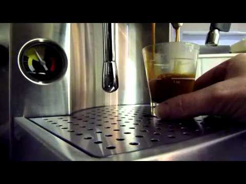

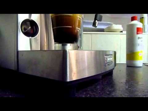

  • I'm going mental trying to get the EM0480 right.  I'm just converting some videos and I'll upload them and post  :-[

  • Ok here are two that I did today using the Spong. First done with 18 grams Second done with 19 grams I can't get anywhere near these with the EM0480 yet...long way to go!!!
