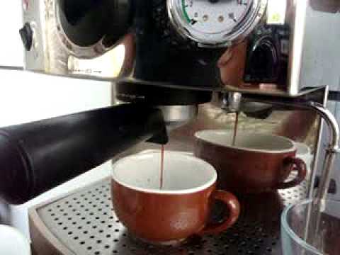

  • Just having some fun sense I picked up a cheap machine $15 in mint cond. $100 for mods  ( Vibiemme OPV and a 16 bar gauge)  and so far it is working unbelievably well...
  • Just completed the pump speed controller It is the little white knob on the side top

  • on 1350802240:
    TIme to graduate to videos C-Man  :thumb:
    here you go---
