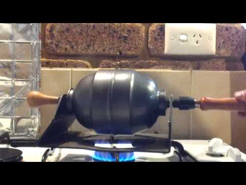

FZRR700 Baby Roaster, by a amateur video producer..
Well, finally done it!
I promised a few here that I would produce a video of the baby roaster, so I ended up producing not one but two.
Produced in full high definition limited by the quality of the phone and a few hurdles along the way regarding the uploads to Youtube.
The main reason I suppose is to reveal the artisan nature of the roaster.
Very much hands on and using a flame, agitation using human effort and using the senses of sight, sound and hearing along the way of the process.
No electricity, and no motor noises, unlike other roasters.
My preference is to use the roaster for single origins, especially for manual brewing.
It roasts well for light roasts, even though it is equally adept at espresso level roasts too.
I like the way that it is easy to hear the cracks due to the copper drum walls and the lack of ambient noise.
The roaster also reacts quickly to change of heat input.
Produces a great tasting result.
The negative side is the inability to roast large batches and the manual aspect.
Wind may impact on the roast if done outside on a gas butane camping stove for example and therefore affect the outcome.
Mine is done in the kitchen with air con on to extract odours and smoke.
Here are the links.

  • Hey Chris, Thanks mate. I,m glad you liked it.  :thumb: Perhaps it will help those who would like to add another roaster to their collection and coffee journey that is hands on and fun to use. Perhaps it will help them understand more about the science of roasting.

  • Thanks for the kind comment Brett,  :thumb: I took the roast into second crack so that viewers can have some idea of what second crack sounds like. Having said that, the taste of espresso taken into second crack tastes really good. Just my preference is to stop halfway between first and second crack to enjoy the origin characters of the beans and appreciate the work of the farmers at origin. Next on the horizon, a full roasting video of the KKTO...
  • Gary, magnificent effort. Thank you for sharing. :thumb: I have the motorized version. I would never have the patience to turn the manual one. I modded mine with a stainless steel hose clamp inside, to act as a stirrer. I still shake it every minute or so. I find the heat source has a huge impact on the roast, and controlling the flame is very important. The little camping stove with Propane canisters works well for me. I tend to open it up and view the beans inside, as well as let any excess chaff escape. They are a great roaster, and perfect for espresso roasts.
  • Thanks for taking the time to put all that together. Watching that don't you just wish we had smell-a-vision... The missing dimension. I've heard you mention you let that go a little further into 2nd crack than is your usual preference. It would have been great if you mentioned in the video where you'd normally stop roasting... And why... Well you know there's a whole series you could be doin... We'll see you on cable with your own coffee show, in no time....
  • on 1389859380:
    You're welcome Lwowiak.  :) There was mention of steel hose clamps being utilized and I,m not sure if it was you. I believe Stucci at CS used a stainless steel serving tongs as stirrers. I have tried installing the same hose clamps you described but it was too damn hard and fiddly. Could not pry open the drum. Tried heating it etc. Nada.

    Cheers Ol Grumpy  :coffee2: The roaster does give a good indication not just the type of aromas, but also the level of smoke that comes out, and with given experience under one's belt, you get to anticipate the next stage of the roasting process and make changes with less stress and guesswork. Thanks for your suggestion. In fact, I,ll take it on board and add a comment to the video regarding my preference for third wave espresso. As far as a series of videos, I still have the KKTO and the coretto, perhaps latte art, milk steaming, espresso porn....
  • on 1389880378:
    I cannot pry mine open as it is welded shut (mine was one of the very first to arrive and needed an adjustment). I placed the hose clamp over the central shaft and pushed it into place with some long nose pliers. A screwdriver is then inserted to tighten up the hose clamp. Long nose pliers are then used to unfurl the "stirrer" arm of the hose clamp. No need to rip the unit apart. I believe you can also undo mine at the motor end, four screws hold the barrel in place on the central rod. I have not tried, because unnecessary tampering usually causes more grief. I hope they will release an updated version of this unit as rumored. If it came with a stirring arm and larger capacity (300g), it would be perfect. I believe the dynamics of the unit change if the capacity gets too large. If you are a fan of third wave espresso, then please wear a fedora when you make your next video production.  :D

    The coffee does not seem to require as much resting time compared to the coretto, you will find that the crema in espresso is not as bubbly, though there will be bubbles present. I found that beans do peak earlier, at the same token will stale faster. The coffee does a slight smokey flavour but is not harsh nor intrusive to the cup.
    I cannot compare resting times to a coretto, as I have never used one, but I find the rest times can be shorter than other methods. You can enjoy the coffee from day one without the usual grassy flavours associated with an under developed roast, but I find the coffee does improve with age, and resting for five days really enhances the flavours. Not sure what you mean by bubbles in the crema. I find the beans peak in accordance with the roast profile and depth. If you roast into SC (rolling) then the beans will peak earlier and stale quickly, but unless it is an accident, I do not roast that dark, apart from a couple of specific beans. Roasting dark and obtaining tasty espresso without ashy flavours is an art (don't knock it until you have tried it). I find most of my beans will last 3-4 weeks with no issues. MM roasted gently peaks at 30 days with wonderful crema. I am intrigued that you detect a slight smokey flavour from the baby roaster. I have never experienced this. With chaffy beans I open and inspect the roast about 2-3 times during the process, so this may be the reason. It is a wonderful roaster with amazing control. I find the addition of  an internal stirrer helps (stainless steel hose clamp), but still shake every minute or so. My suggestions for an improved version would be: -internal stirrers -increased capacity. I believe the unit could handle 300g if its size was increased in accordance with its unique design and shape. The camping stoves produce heaps of heat, I never use the flame any higher than 50%, so there is the ability to increase the batch size; if the size of the roaster was enlarged. Keep the roaster away from the wind. I roast in the garage, with the door and windows open. The roasting smell stays around for days. Only a very brave man roasts inside. My wife would reward me with a kiss on the back of my head (with her cast iron frypan).

  • I normally can hear both first and second crack with all beans even under a operating rangehood. I aim for 9-10 minutes to first crack due to less lag of the small batch compared to bigger mass of  500gm for a coretto. Turning the handle certainly is tiresome if you only use one hand. I use one hand to turn initially, then when finger fatigue sets in, use the other hand help turn in order to alleviate effort. You do find out turning the beans are easier when they get to yellowing stage onwards compared to green when the bean surface is smoother and heavier. I did not find much of a difference in color compared to the coretto. Light roasts are excellent. Impressive results through the Curtis Gold Cup brewer and compares well with the cafe,s golden bean winning yirgacheffe.

  • Sorry for the lag Sam, With reference to cupping, I take it to 30 seconds after the end of first crack. For filter, anywhere from 1-1.30 after first crack. For espresso roast, 2.30-3.00. The roaster certainly provides good sound and aroma clues, with limitations on visual due to having to open and peep.
