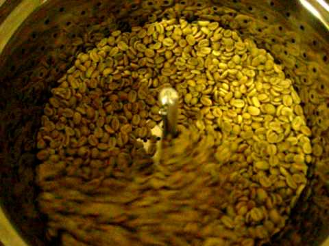

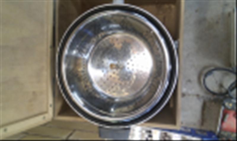

Quick update on the hybrid. I've had a concern with the tapered sides of the bean bowl/roast chamber since the first roast. The beans had a tendency to get pushed up the taper rather than tumble over the agitator. So, I popped over to KK's today to drop off some loaner tools and have a perve at his.....new kitchen :rofl:. Anyway, KK produced another bowl to try along with a new agitator. The new bowl is still tapered at the bottom but has much more vertical sides. A few swapping of bits and brackets and a tweak of the agitator and its going better than ever. I'm really happy with the way the beans move now. Cheers KK, your generosity in incredible. Oh, your kitchen kicks arse too. I made another vid. The first part is with 10 volts and the second is about 8.5 volts. I like the way it performs on either setting but 8.5 V looks better on the vid. A few photos showing the new bowl and agitator and a comparo photo showing the different profile of each bowl. http://s1174.photobucket.com/albums/r603/derrilex/roaster vid test/?action=view&current=VIDEO0029.mp4

That video looks a lot better overall in agitation and the new perforated insert looks like its keeping the beans inside nicely Let's do an update on the next roast day as a comparison of the previous set up to the new And the pleasure is all mine to help out whenever I can.
I was going to roast again this arvo but it got too dark and rainy. Tomorrow weather permitting I'll do 600 of terranova, which were the greens in the vid. I think its pretty good now KK. The vid is deceptive. Even on 10 V the speed is pretty good but the vid makes it look fast with the beans blurring. Agitator works well, not much catching of beans and and pretty good action. I think one could play forever with it.
