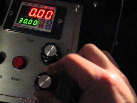

Thanks for replying Kevin! Did you follow the settings as per cosmic couple's instructions above or did you improvise with your own? What drop temperatures are you starting out with and what power settings/fan settings? No one has really mentioned about the PID temperature settings as yet (lcd other than the timer)...do you use it or just the power and air dials? Let's learn together. I've gone ahead and placed an order so waiting patiently now.

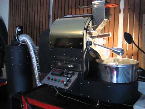

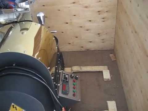

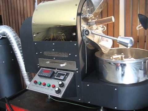

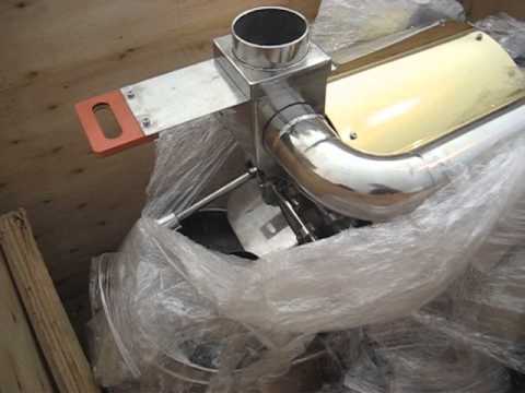

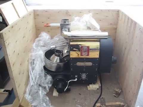

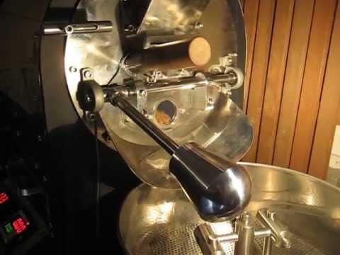

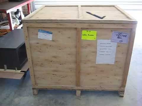

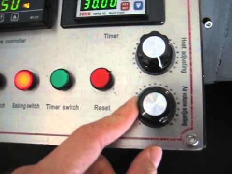

Just an update for this thread. I received my roaster and here is the unboxing videos I did. [embed=425,349] [embed=425,349] [embed=425,349] [embed=425,349] [embed=425,349] [embed=425,349] [embed=425,349]
Wonderful videos. Thank you so much for taking the time to post these! If I hadn't already had several "mid-life crises" this year your vids would have tipped me over the edge.
Congratulations Saoye It looks very nice, I know you will have a great deal of fun with this, I stepped up from a coretto to Quest M3 then this and love the thermostability, the nice smooth curves you can get and nicely repeatable profiles. Are you running both the CS meter and the temp controller off the built in tc in the last video? Chris
+1 Saoye, I enjoyed each individual video. I will be interested over the coming period your impressions and the overall experience in the purchase of the unit. Jonty
Thanks Chris, yes I am running a Thermocouple extension lead off the built in tc of the roaster and back into my multimeter which is bought from the CSs site into my laptop running the CS software. I have had to make quite a large calibration as per Graham's instructions on the CS software to make it more or less aligned. There is certainly some form of electronic interference of sort that disrupts the reading when the power is turned on, I noticed a significant dip in my reading when the 180deg Celcius alarm went off on the roaster and after the alarm the reading stayed approximately 5 degrees below the roaster reading. I will turn off the alarm and see how the curve looks like on my next roast.
Great vids saoye and congrats on the unveiling process. It is almost identical with mine, purchased from John via the evilbay. The only obvious differences I can see are that yours has no drum speed control knob and no sliding lock bar to hold the bean drop door open. I am still roasting without any data logging as I continue to attune myself to the process, but still want to go with DL roasts. I sold my CS Temp DL when I sold the Behmor and will probably go back down that path and buy another unless you and/or others here can suggest a better/easier plan. Piggy backing the CS of the roaster's thermocouple as I currently understand it, helps with the roasting profile logging, without monitoring actual BT. I was intending to go down the road of installing a BT just above the viewing glass as suggested here earlier, but now wonder if that is really necessary if results are good through just the piggyback method. I am by no means an electronic techie, so would appreciate any advice. I am enjoying the resulting roasts to date, but like others here, know there is always room for and the passion to get the best from this rewarding hobby investment. :coffee2: Cheers, Kevin
Hi Kevin. I am too used to using a data logger not to have one and piggybacking is better than nothing. The tc in the roaster is just below the tryer so it is at least touching beans but yes not in the main bean mass where the viewer is. I am thinking using the hole of one of the bolt holding the viewer in place for bean temp. For now I'm ok with the piggy back method. I got mine from north coffee direct. Mine does have the sliding bolt bar. I think the latest version has the tryer and door hand and bolt on the same side. I will do a full YouTube review next week.

Great to see you are getting nice results at just 5 roasts in, saoye. I tried to reply to your post earlier today with a fairly detailed post and then attempted to attach 2 Fotek pdf files that John sent me, to help you "get into the menu", left the computer to make a coffee and returned to find a message saying it was too big a file to post on the forum. Needless to say the body of my message was GONE! :'( So, a couple of clients later and some tiling duties, I'm trying again. ::) The PID and the Fuzzy Temperature controller PDF is 2570KB and the Digital counter file 2227KB, so we may have to email it direct if you want it. Suffice to say; I think you are on the mark with the SV temp setting role. I think my roaster was set at 300 deg when I got it and thinking that to be too high, I reduced it to 230 deg. Yeah, maybe I think too much. :pan I will reset it to 300 when I next take the cover of to roast again to see what difference it makes. On Tuesday I dropped in 1135g of Nepal Plantec Estate (finished the bag) at 190 deg, achieved 1C@ 13:10 at 168 deg. Couldn't detect 2C and pulled them at 17:50 at 194 deg with end weight at 928g. Not tried yet but looks good. Immediately after, I dropped 1Kg of Nicaragua Mombacho SHG @192 deg. 1C @ 11:00min at 174 deg. 2C 15:40 at 191 deg. Pulled @ 16:00 at 193 deg with an end weight of 812g. Note; these temps are read from the PID and are not actual BT. Cheers, Kevin If you send me an email to kejari at big pond dot com I can send the files to you. I appreciate your input and experience
